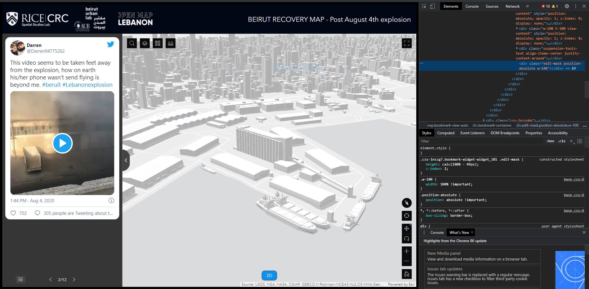

My app in Experience Builder has now a bug on the Bookmark Widget, which only appears on draft and live views.
My bookmarks contain embedded content, which out of nowhere are not interactive anymore. Inspecting the code on Chrome I noticed that a mask div was created on top of the widget, which prevents interaction with embedded content. If I delete the code for this "mask", the embedded content becomes interactive again.
see image below:
This "mask" does not appear in the in the editing environment, but does appear in draft and live views.

Please ignore my comment above. I figured out. I think you mean "Live view" is app launched. And I can reproduce it now. We will try to fix it asap in coming patch.

Thanks for your feedback. When saying "...not interactive anymore" do you mean like the video play button is not interactive in live view mode as the screenshot shows?
Unfortunately I cannot reproduce the issue. Could you probably share the embed URL and other details?

Wei_Ying
Wei_Ying
Hi Bruno,
We have fixed this issue in tonight's patch. Thanks again for your feedback.
