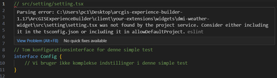

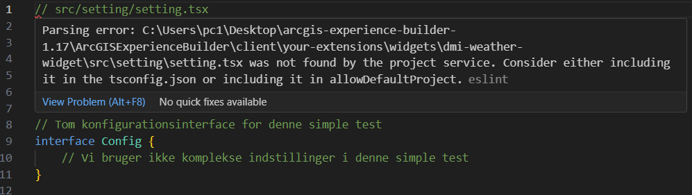

I have made a widget which works, but cant seem to figure out what i have done wrong in the setting.tsx. And i cant get rid of this error.
Parsing error: C:\Users\pc1\Desktop\arcgis-experience-builder-1.17\ArcGISExperienceBuilder\client\your-extensions\widgets\dmi-weather-widget\src\setting\setting.tsx was not found by the project service. Consider either including it in the tsconfig.json or including it in allowDefaultProject.eslint

Hi Jeffrey,
I continued to look into what could be the reason for this and i found out that the Dist folder was placed differently in my folder structure than in the documentation for the structure, so it was the manifest' linkage to the setting.tsx which where the problem.
