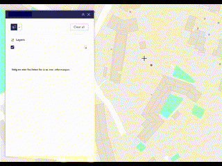

I have come acrosss a weird behavior of the Widget Window and Select Widget. When I close the window, not minimising it, the expected behavior if the Select Widget cursor is activated would be to close too in my opinion. It does not close but remain active even when the widget window is closed. Is this a bug? If not, it would be very useful to have the option to have the Select Widget terminate completely when closing the widget window. I have attached a GIF recording of the mentioned behavior.

Most people I have user tested this web app with find it confusing as an 'X' usually indicates closing (quitting) an application or in this case a widget. So when the select tool doesn't disappear when quitting the widget with the 'X' button this breaks that design pattern and how people are used to interact with the GUI. Since the widget has a minimise window button, that further indicates that the 'X' button should quit the widget and its processes.
