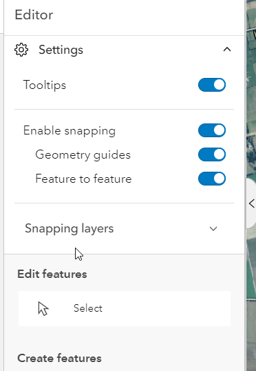

Hi ExB community,
I logged into an Experience Builder I had made a while back and noticed Tooltips under Settings on the front end user interface.
Has anyone used this yet? Is this what I've been waiting for- where I hover over one of the dropdowns or questions within the Edit widget and a tooltip comes up? Hope so! Is there any documentation on this or a link to an article?

Hi @elpinguino ,
Apologies you never received a replied for this post.
You've probably figured this out by now, but these tooltips are meant to be used to help with drawing features using specific length, distance, bearing, coordinate values.
This are actually explained here: Editor | API Reference | ArcGIS Maps SDK for JavaScript 4.31 | Esri Developer

Hi Alix, I was wondering if it's possible to change the tooltip unit from the metric system to imperial? I am based out of the US and my users use feet/miles. Thanks!
AlixVezina
Hi @B_NewGE , I believe if you are not signed in, the tooltip units are based based on the spatial reference of the map. If you are signed in, you can set what type of units you want at the org level and in the user's profile.
