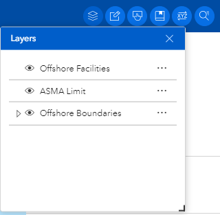

Hi All,
Are you able to expand grouped layers in the Layers Widget in Experience Builder (ExB) by default? And further to that, can you expand some by default and keep others collapsed? Thanks.
 Jamie.
