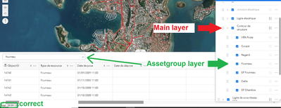

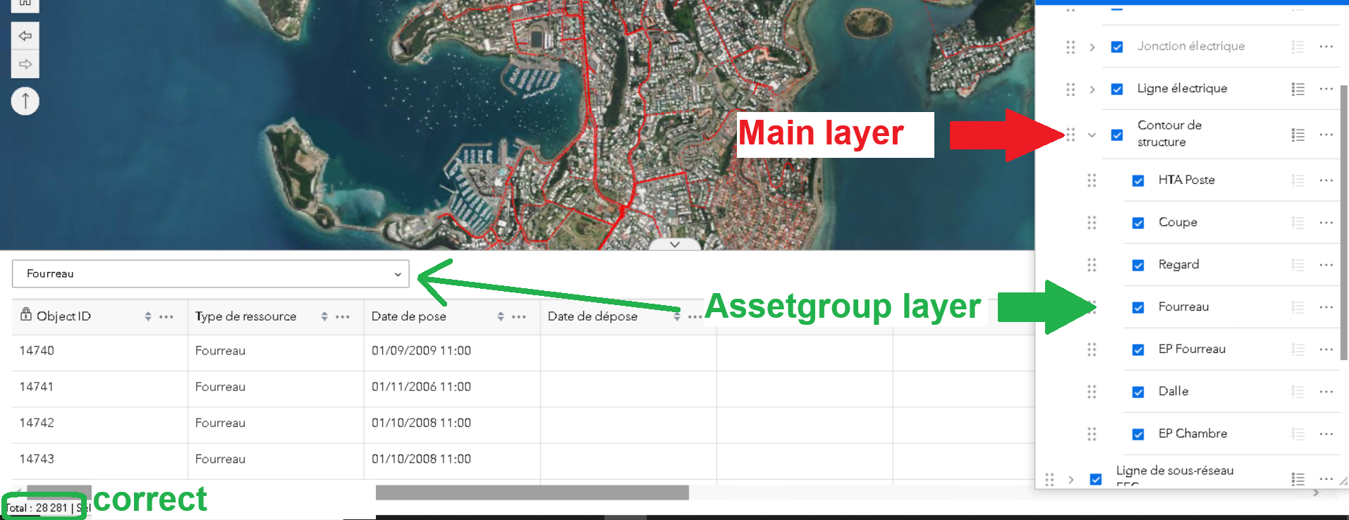

I am using experience builder 1.17 to display layers belonging to an Utility Network. When I open a sublayer in the table widget, the total number of rows is correct.

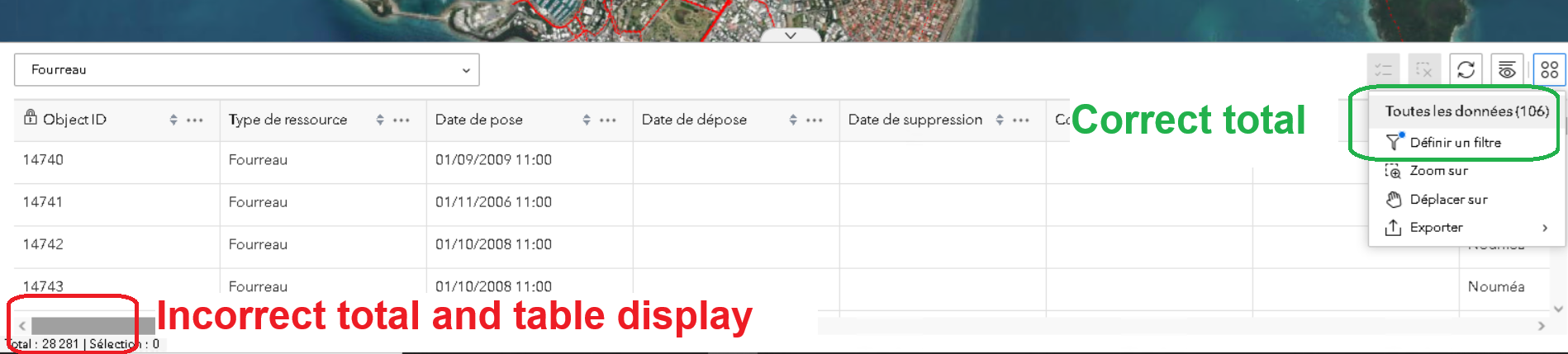

However, when i apply a custom filter, the correct total is displayed on the dropdown list, but not on the main table, even after refreshing with the refresh button :

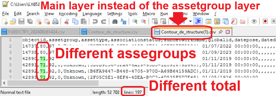

Moreover, when I try to export the table with the dropdown option, the generated CSV/json file seems to honour the custom filter, but it includes data from others assetgroups.
Have you encountered similar behavior ?

Hello @MatthiasBoucher - thanks for reporting, this should be a bug with the table widget. We'll take it from here.
Shen Zhang
Shen_Zhang
Hi @MatthiasBoucher - the issues you mentioned have been addressed in the ArcGIS Online October 2025 release today. The Experience Builder developer edition will be available in about two weeks, and you can check the fix in ArcGIS Online if you have access to it. Thanks!
