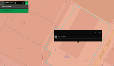

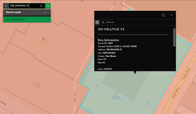

I am having a similar issue. I have an Experience Builder application currently utilizing a Hosted Feature Layer. I am trying to replace this Hosted Feature Layer with a Map Image Layer containing the same data. Running the Search widget on the Feature Layer will zoom to the selected feature and bring up the popup with its attribute information as shown in the screen shot below:
However, running the Search widget on the Image Layer will bring up an empty popup with no attribute information as shown in this screen shot:
I believe I have these layers configured in exactly the same way in the application. Does anyone know why the application might be behaving this way?
