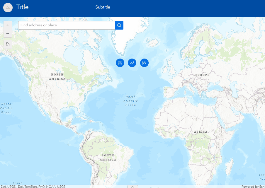

A basic Experience Builder setup with a widget controller. When the measurement widget is opened and "Start Measuring" is selected, a map interaction is activated. If you switch to a different widget within the controller, this measurement map interaction is automatically canceled (as I would expect).
However, in the elevation profile widget, switching to another widget does not cancel the active draw interaction; instead, users must manually switch back to the elevation profile widget and hit "reset" to stop the interaction.
Is this the intended behavior?😉
