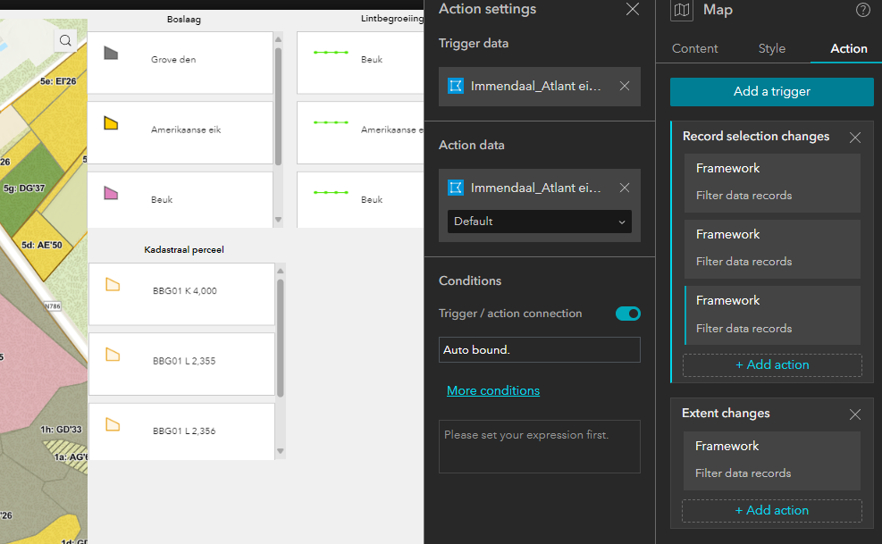

I am wondering if others also encounter this issue.  I encounter this issue in a client enterprise environment (10.7) as well in our company enterprise (11.1).
Created this ExB for this issue in our Enterprise.

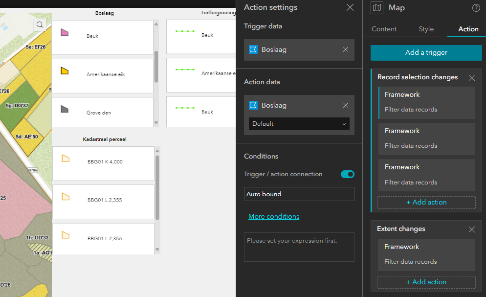

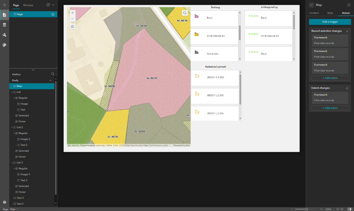

Defined actions on map widget
Record selection changes Action 1: filter Boslaag to list Boslaag
Record selection changes Action 2: filter Lintbegroeiing to list Lintbegroeiing
Record selection changes Action 3: filter parcel <-- wrong action needs to be deleted.

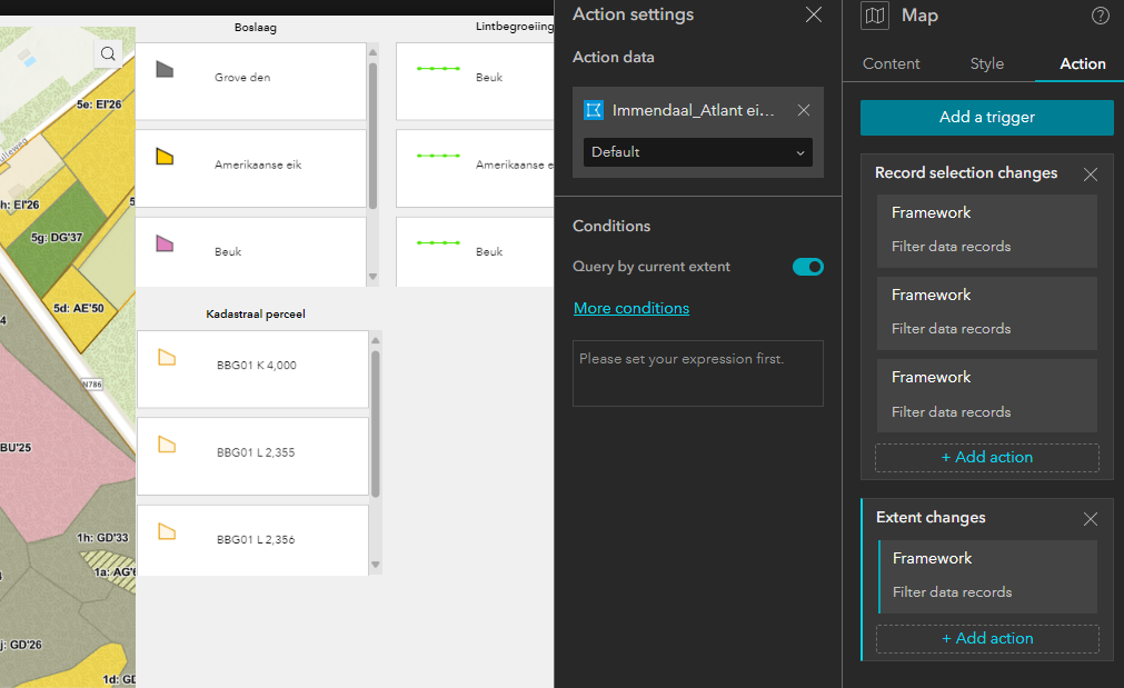

Extent changes Action 4: spatial selection parcel based on map extend, filter to list Kadastraal perceel
Deleting action 3 on map widget

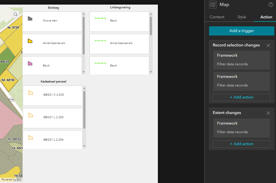

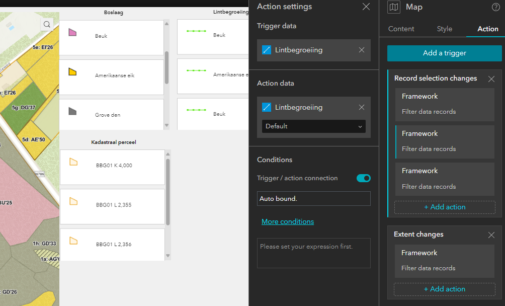

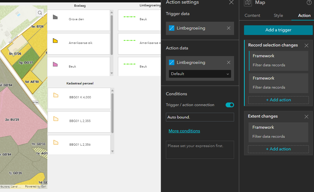

After deleting ‘Record selection changes Action 3’, two actions in Record selection changes remains.
But the ‘Record selection changes Action 1: filter Boslaag to list Boslaag’ has been deleted.
Action 1: filter lintbegroeiing to list Lintbegroeiing
Action 2: filter parcel (which should have been deleted)

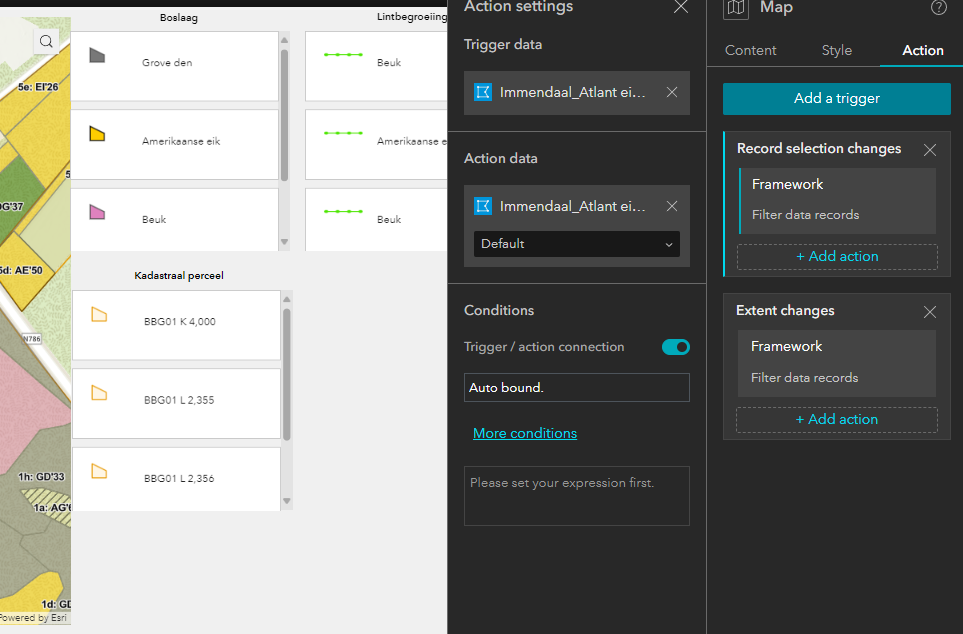

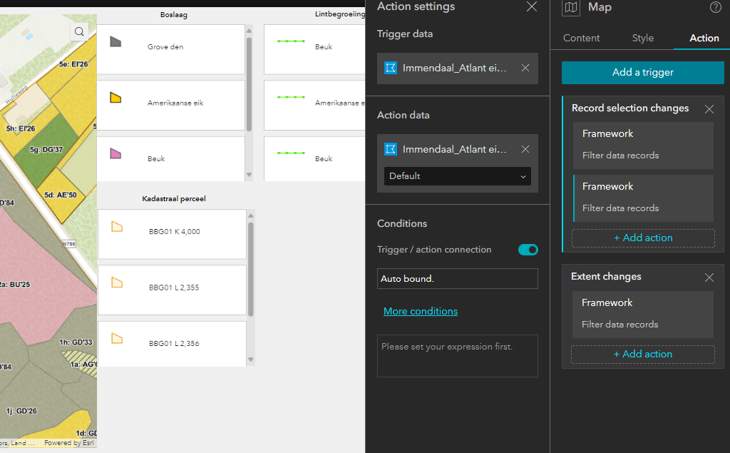

When deleting now action 2, actual action 1 is being deleted.
It seems that the action first in the list is deleted instead of the selected action
Stefan_Thorn
Update: esri not able to reproduce this issue.
Workaround: move the action to be deleted to the top of the list and then delete the action.
