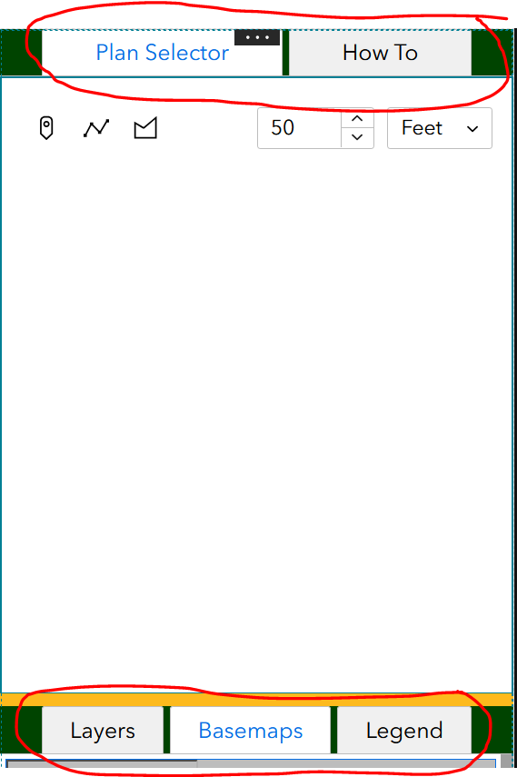

Stacked widget tabs - change the appearance without changing other colors in the map or unrelated widgets?
3043
9
01-30-2025 11:51 AM
AdamGebhart
I am testing out stacked widgets (to create tabs) in a grid column.  I would like to change the tab appearance (default, selected, hover) but don't see that I can make any or even one of those changes without also changing the map background color.  Is there a way to do this or is there a better way to stack widgets to make tabs (and modify settings)?  I'm in Developer 1.16.
The grid rests within the second sidebar.
I can change the font color via the primary theme color.
If I change the third color that updates the default tab background color but it also changes the map background color, as well as the color of the map widgets (zoom, home, etc).
Maybe a CSS file somewhere can be edited?  Should I try a completely different path?

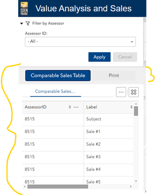

A workaround is to place a Section widget inside a column widget , and then use the view navigator widget as your "stacked tabs." That will give you a lot more control over the look of the tabs. Here's an example from an app of mine. I have a column that contains a filter, then a view navigator, then a section with two views: "Comparable Sales Table" and "Print".

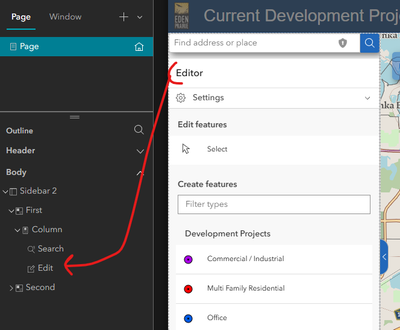

ZachBodenner
MVP Regular Contributor
I've not run into the issue of a view not being openable on start up, but I have used the view-in-sidebar just fine (edit widget, but the Near Me should work fine).
Happy mapping,
- Zach
AdamGebhart
Thanks again.  Can you possibly attach an image of what your Page contents (Body) looks like on that app you mentioned?
ZachBodenner
Sure thing!
This one can occasionally get dicey because having the editor always exposed can lead to problems, so actually the side bar starts collapsed, but that was a change we made after having a few accidental deletions, so I know it works with it set to open by default.
Happy mapping,
- Zach

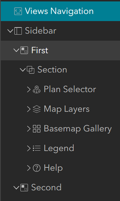

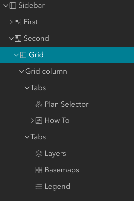

AdamGebhart
@ZachBodenner
Sorry, here are some images of the app I mentioned I built using the sections and views.  I essentially followed the Tab template in ExB.
