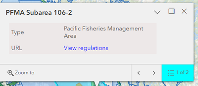

When a user clicks a spot with overlapping features, the pop-up panel that is triggered displays on the right-corner a 'feature-menu-button' and R/L arrows, indicating how many features overlap and prompting the user to click through to view their details.
I am using Experience Builder Developer 1.12.
I want to change the background-color of the 'esri-popup__feature-menu-button' to cyan to draw the user's eye to ensure overlapping features aren't overlooked. I think I can do this by creating a custom theme and adding a style.ts as described in this Sample Code, but I don't know where to find and identify the elements. Where do I begin?

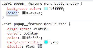

The demo screenshot was made to the HTML page by adding

You have already found the class name of the item you wish to change 'esri-popup__feature-menu-button', so in style.scss add:
.esri-popup__feature-menu-button {
    background-color: cyan;
You may need to use:
    background-color: cyan !important;

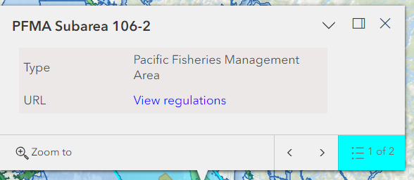

Thank you so much, @JeffreyThompson2! Going the route of adding the 'style.scss' was very straightforward!
I will leave the css-in-js approach to a rainy day. Thank you so much!
