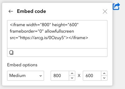

Usually you can simply copy the experience URL and imbed to other app.
To get a better iframe code, you can also add a Share widget in ExB experience, and then from the Share widget, you may find "Embed" option where you can customize the size for iframe and then copy the code to use.
