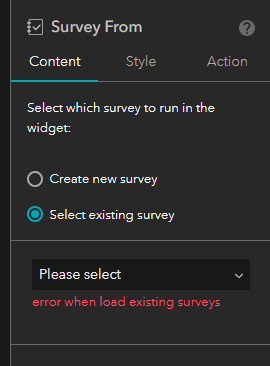

Hello,
I am trying to add a survey to my experience builder page, but it is unable to find any existing surveys. I just get a generic error whenever I try to load the list. (see screenshot)
I also tried the "create new" option, which worked, but I am unable to even see the newly created survey if I try and re-add it to the page. Survey loads and works correctly outside of Experience builder, and is shared organizationally.
Survey123 version is 3.17
This is on ArcGIS Enterprise v10.8.1

I actually opened a ticket with ESRI, and they brought up that this is a known bug inside 10.8.1 and is fixed in 10.9 so our solution (unfortunately) was to wait until we can upgrade our environment.
