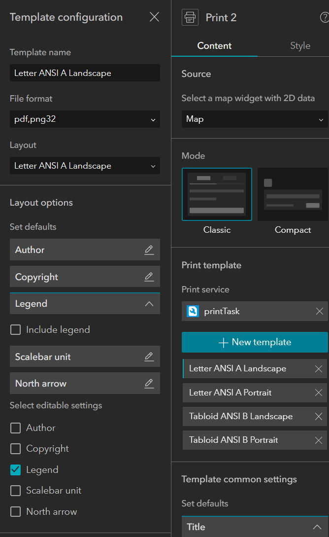

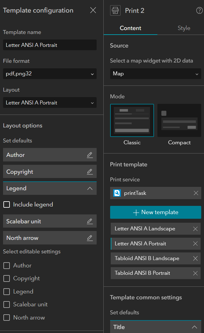

Recently, our print widget stopped working. I went into EB and saw that it was corrupted on the back end, and I feel like this happens whenever there is an update to EB. So, I pulled in a new one to reconfigure it and it will not allow me to check the box for the legend to be turned on my default, no matter what I try to do. It just won't let me check the box!
Please fix this ASAP! To have our users have to go into the advanced settings and turn on a legend every time they print is exaustive.

@KaraUtter2 I can reproduce it. Will let our team know, and thanks for bringing this up.

Thank you for the response. Do you know how long it will be until this bug is fixed? Having a legend in the printed maps is a pretty important feature.
TonghuiMing
Hi @KaraUtter2 - This issue has been fixed last week. Let us know if you have any other concerns.
