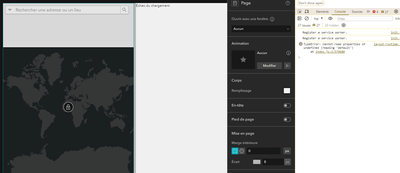

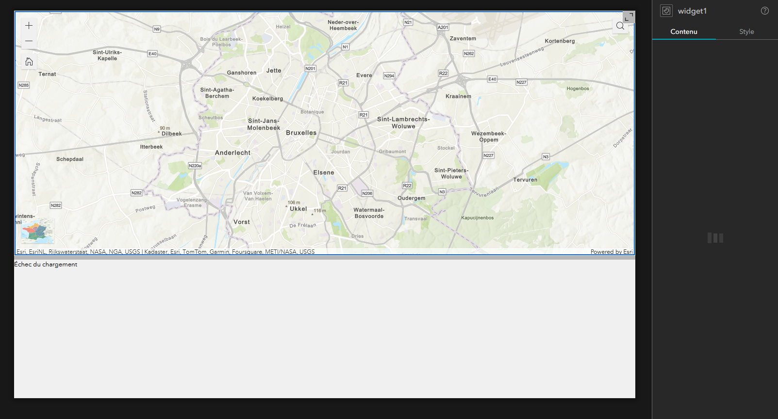

Hello everyone,
I have developed a custom widget that interacts with a Map widget. Everything works perfectly fine locally.
However, once I deployed it on my Enterprise portal, it fails to load both the user interface and the configuration part.
Does anyone have an idea where the problem might be coming from ?

I just checked, I have version 11.1 for my AGE (ArcGIS Enterprise), and version 1.10 for ExB (Experience Builder).
The problem is still present.

what error is in brwoser console?
I would contact Technical Support.
