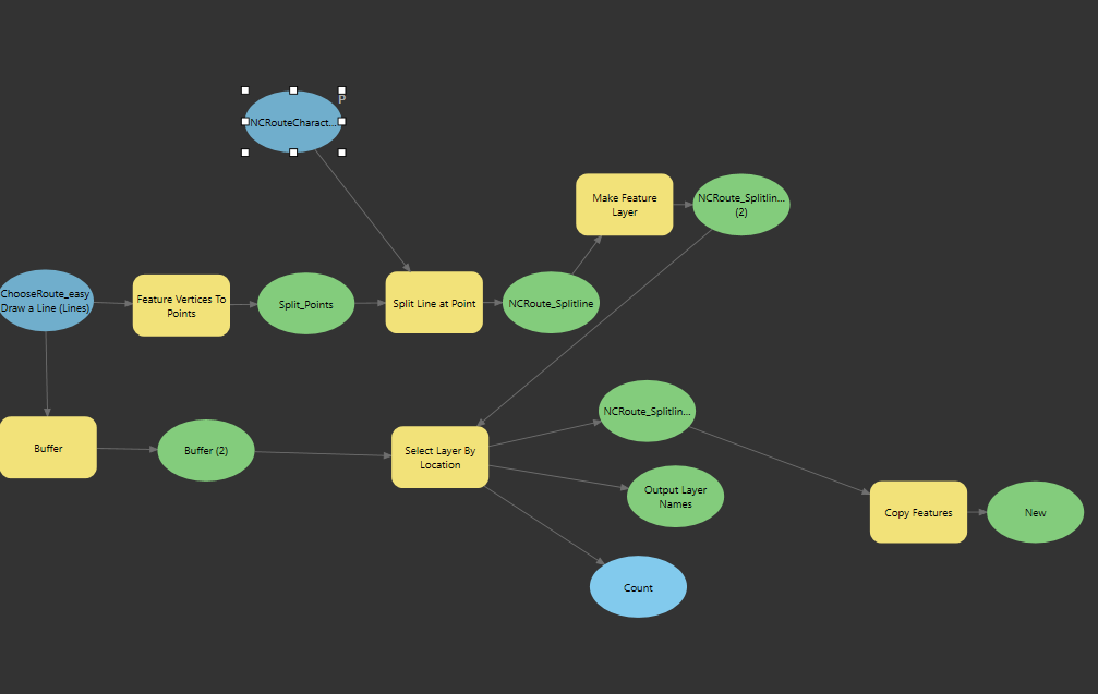

I created a Model below

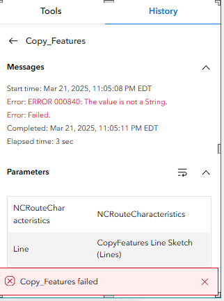

I made both my inputs feature Feature  sets in the model builder. When i publish this model into my arcServer and then run it i get the following error. Generally what are the rules when it comes to how to treat web application features on a web app for a model builder. are the inputs feature layers?
Wei_Ying
Hi,
Feature set is a supported parameter type. And from app runtime, most of the case the feature input are feature layers. It should work.
Do you have any other information for this tool? Does it run successfully if you run from Web AppBuilder?
