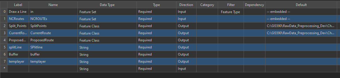

Basically, I want the user to choose any section of a route (routes are typically random lines segments) and it will copy that section. The tool run successfully in ArcGIS when things were hardcoded.  used arcpy.GetParameterAsText(#) for spots that had hard code but I don't necessarily want my user to be naming things that are intermediate steps. I attached my code and here is how i set up my parameters.

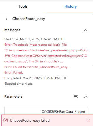

When I publish my GP tool on my ArcServer and I add my custom tool to an analysis widget, I have the necessary data within the web map to run the tool. i get this error.
Overall, I only want my input to be a route that the user selects and everything else to be coded so it shows up with the name I choose so that it is clear for the next steps. I am not sure how to get a feature class to show up as an output without marking it as a parameter within the arcGIS tool. Any tips on how to set my parameters so that it will run within my web tool?
