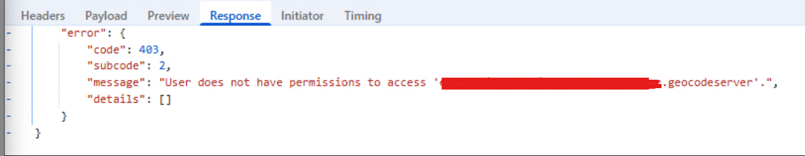

We have Published a Geocoding Service on AGE 11.4 and using it for Batch Geocoding in Experience Builder Dev 1.18.
We observed that a user is facing error 403 insufficient permissions issue when trying to perform batch geocoding by utilizing the Geocoder in a custom widget in Exp Builder 1.18.
Note:
  • The Geocoding works if the Geolocator is shared with Public(Everyone)
  • The Geolocator also works if the user is made the owner of the Geolocator
  • The user can access service REST and also perform query
Any suggestions as to what we can check?
So far we have tried below:
  1. Make the user an admin, fails
  2. Create a new Dev Creds using admin creds, fails
  3. Add redirect URLs in the app settings, fails

@Yogesh_Chavan can the user access the Geocoding Service by URL?
Yogesh_Chavan
Hi @Wei_Ying , thanks for checking. Yes the user can access the service URL.
The issue is solved. It was related to the method used for authenticating the service in the widget.
