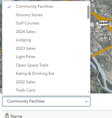

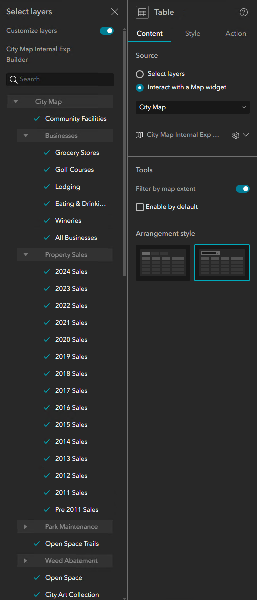

I deployed Experience Builder Developer Edition 1.16 today, and have encountered the following bug with the table widget. When switching the table to Interact with a Map widget, and then customizing layers, the list of layers is in random order vs the web map order. Below is how my layers are ordered vs how they appear in the layer list of the table widget. Is anyone else getting an issue like this?

Update on this after a support case with Esri. It is a bug and logged as BUG-000173776. The alternate solution is to: "Under the Table widget configuration options, choose Select Layers instead of Interact with a Map widget."
