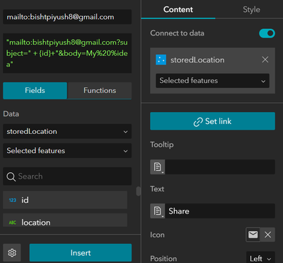

jauhari_mani
@LindaSlattery @JRhodes I want to add attributes in the subject and body of the mail,But i am not able to achieve it.Can you pls explain the steps how we can achieve that?
