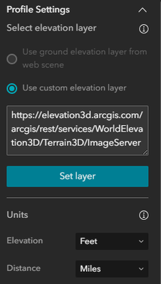

I need to produce an elevation profile in my ExB app using a custom elevation layer. I have successfully done this using the instructions to "Create a tile package for a web elevation layer" here. However, I noticed that the elevation profile graph that is created in ExB is different from the one I created in ArcPro, even though I used the same elevation and line layers. The elevations are showing correctly in Pro (a range from -0.3 ft to +1.5 ft, see first screenshot) but in ExB, they are showing as -0.85 ft to +4.81 ft (see second screenshot). It seems like even though the elevation layer elevation values are already in feet that ExB thinks they are in meters and converts them?

Hi @AnninaRupe1 , please check the following:
  • You map spatial reference and your tiling scheme; I wonder if using WKID 102100 might be defaulting your units to meters.
  • Check the display units settings in the Elevation Profile widget, under Profile Settings.
Otherwise, are you able to share the elevation service you're using?

I have checked my spatial reference and it is 102711 (3424). I have also set the Profile Setting units in ExB as Feet/Miles. I have set the elevation tile cache sharing setting to Public; let me know if you can't access it. Here is the URL
