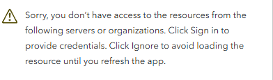

Hi All,
What is the best way for users to stay signed-in for experience builder applications that are utilizing ArcGIS Server Services. Every time the application refreshes users are prompted to sign-in. Which can be tedious for internal users.

becyr
Hi  JeffreyThompson2
I am using ArcGIS Online.
