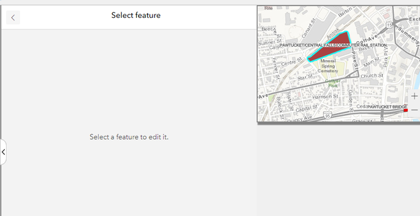

Hello!  Thanks for any ideas on this one.  The current Editing widget when opened always states "Select a feature to edit it" even if the bound map has a current selection.  The user has to click on the map again to select the same feature again before the editor displays the selected feature's attributes.  Does anyone know if this is a current limitation and if there is a workaround?  I have a custom version of this widget in the developer environment so can insert custom logic.
Thank you!
Sam

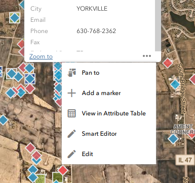

jcarlson
MVP Alum
In an app with editing widgets present, the popup itself has links to those widgets, which, if clicked, open the widget with the given feature already active.
Perhaps you can look at what's going on there and see if there's some code you can re-appropriate?
