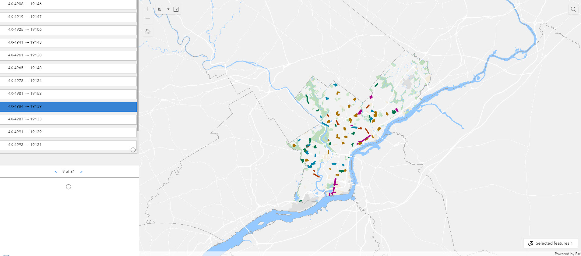

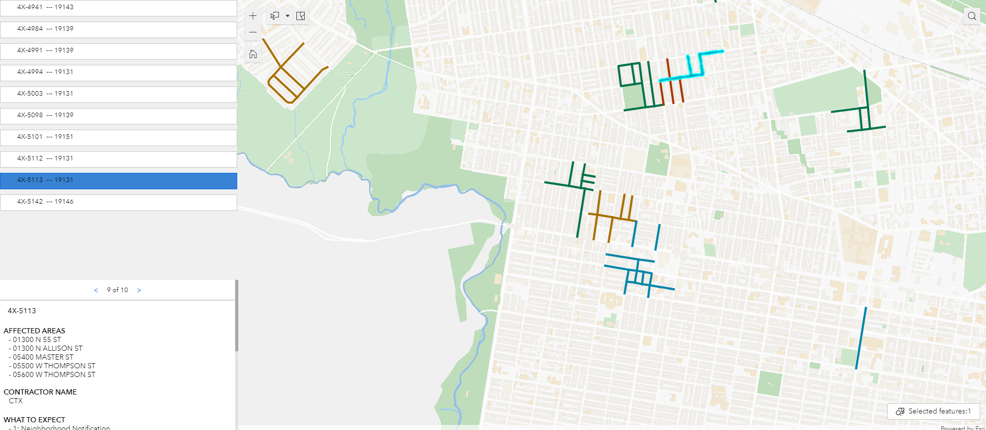

I have a list, map and feature info widget, the app behaves like this: a click on a record on the list - map zooms to the area - list changes to records in the area - the selected record changes to another one that's not selected by me - sometimes it changes back to the one I selected, sometimes it stays with a random selected one. What should I change so that the selected record does not change?
Here is what I see: I select 4X-4984 on the list
Then the selected record changes to 4X-5113 after zoomed in. Sometimes it changes back to 4X-4984, sometimes not.

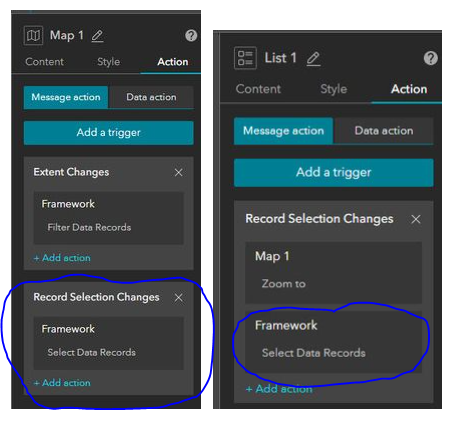

Here is the trigger on the map and list widget:

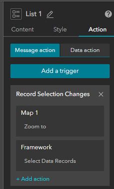

I don't understand what purpose is served by the actions circled below:
Have you tried it without them?  I don't need them to do what you describe in the workflow above (zoom to selected in list and filter visible records in list based on map extent).
ChiZhang2
I thought I needed to set up the selection triggers myself. After I remove those triggers the map does work the same as before.  However I still see the same behavior.
DaveFullerton
Yes, Map and List have those triggers/actions by default.  It would be nice if Esri would provide documentation showing everywhere they have done that type of thing.

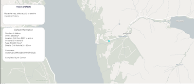

I'd remove the feature info widget and replace with a card, in that card link data to a text box and tick "Selected Features", removing the tick from Default. Create your own view of the feature info. Example below, I've got a filter enabled, extent filter and the card is displaying my selection.

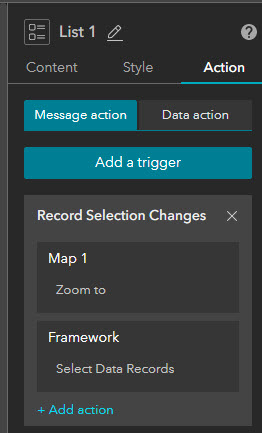

The list - I want to select a list item to give me the related table data. So I want to create an Action, in the list, to select data records from the related table, again this is at Framework. I usually create a card with text connected (by selected features) to the table data. The trigger data is the feature list, the action data is the related table - and you use the GlobalID to ParentID (GUID) as the relationship (or however your relationship fields are defined).  Therefore, that list selection will give you the related data in the card with connected text.
At this very simple level, there's no other actions need be applied. Map -> List -> Related Data. Just as an FYI, this will also work with views of the data created in ExpB too.

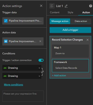

Thanks a lot I never thought this way. Using your method I can get related data show up in the card. However it only shows one related record (block) - I usually have multiple. Is there any trick?
Here is what I did: card text and list action.
