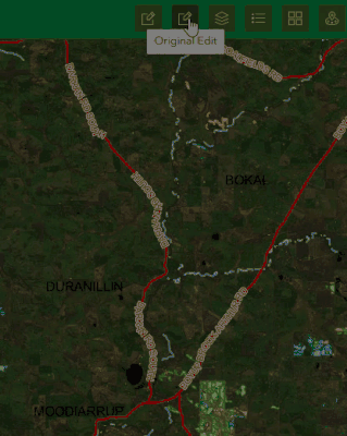

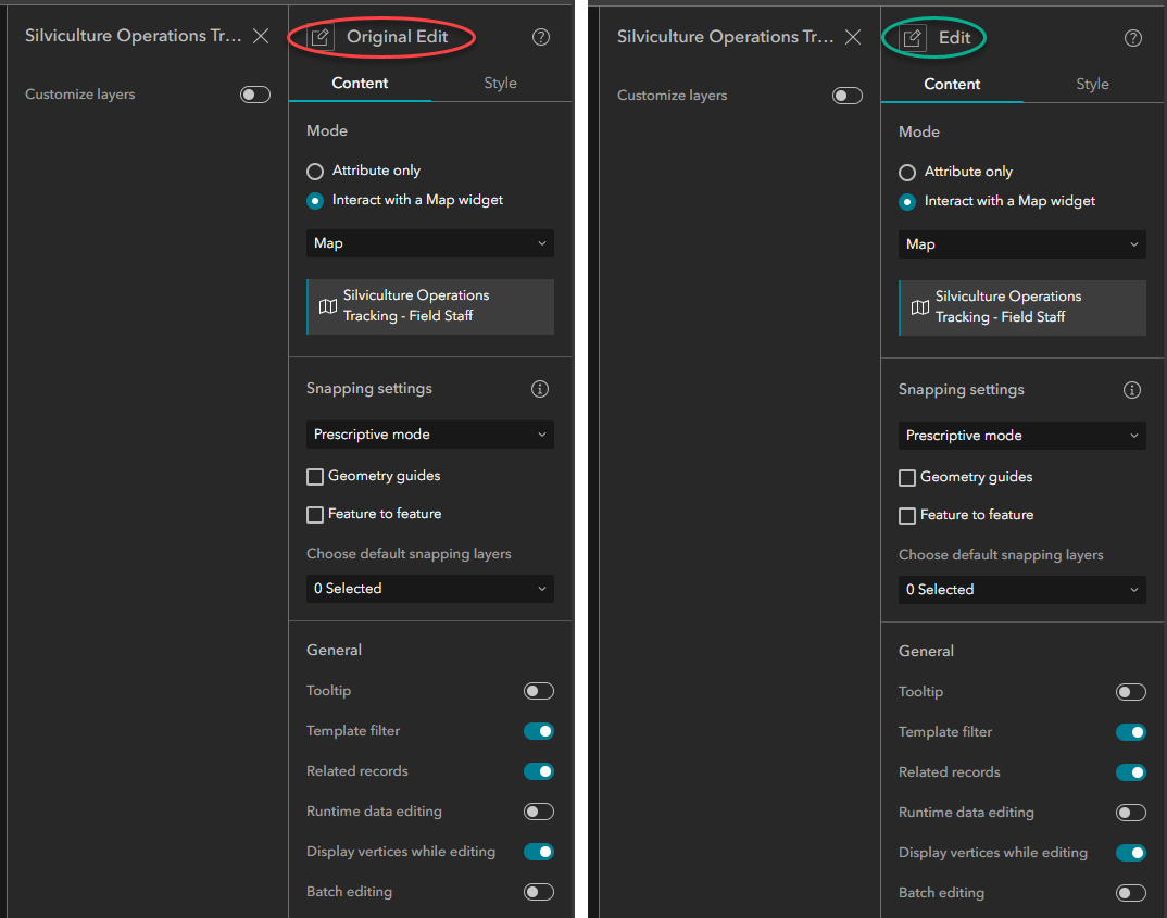

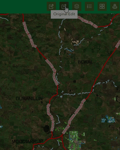

We have found that in some of our Experience Builder webapps, the Edit widget is failing to load up properly after the June 2025 updates have been applied. In troubleshooting the issue, it also seemed to be inconsistent for different users despite all being the same user type and role plus in the same groups.
After trying to recreate the Edit widget from scratch in one Experience Builder, we thought we had fixed it. So we deleted the original, renamed the new one back to "Edit" and , oh wait - nope still not working. Rename to something else, and it works!!
Moving on to the 2nd EB app that I've found with this problem, and I implement the same fix as above and get similar results - 1 works and 1 doesn't where the new one was loaded in side-by-side with the old one.
Anyone else finding issues with their Edit widgets post updates?
Both edit widgets are identical.
