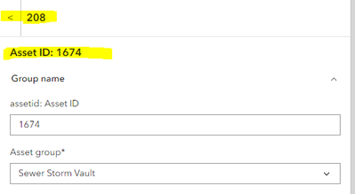

AlixVezina
@YS2388 Just wanted to let you know that with the upcoming fix for this, the smart form title will be displayed at the top of the form (in the example below the smart form title is "Asset ID: 1674"), but the display field will still be shown in the header next to the back button. This is a known limitation for now.
