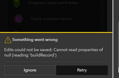

The editing was working ok a couple of weeks ago, but now we get this error when adding new points.
Edits could not be saved: Cannot read properties of null (reading 'buildRecord')

I also encountered this error at one time when using the editor widget in Experience Builder. I found when I went to check the editor widget there were several layers with errors in them, likely from changing the schema around after the Experience was published. Once I removed the layers and re-added them, the error icons went away, as well as this error message when trying to add and delete features.

The only difference between your experience and mine is that I did not change anything with the schema or changed anything related to the experience (map and feature layers). I noticed though based n your suggestion of removing/adding the layers, that my layers had a warning sign that says the data is inaccessible.  Another thing is before fixing it, if we did press the "Ignore" on the error message it does create/delete the data, and "Retry" would be an endless loop of the error message.
