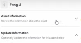

Firstly, in the demonstration video it is showing the Feature ID as a value (in this case a water network component ID), whereas when I set it up with my own data, it defaults to the ObjectID. Where is the Feature ID pulled from in this widget? I have tried a few different things to get it to pull from a different field but with no luck so far.
Screenshot from 03:08 in the video
Screenshot from 03:08 in the demo videoScreenshot from 03:08 in the demo video

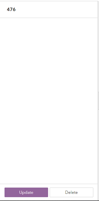

Approach 3 - edit feature: allows me to click on a feature in the list , but only the objectid (feature ID) displays in the edit widget. No fields are available for editing. The objectID does update if I select a different list item, but that is it.

Regarding your first question and the Feature ID, right now the widget is displaying an attribute value in the header. The value is picked from my service's "Display Field", which I have defined before publishing the service from ArcGIS Pro as shown here: Re: what is the display field - Esri Community.
