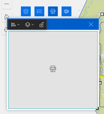

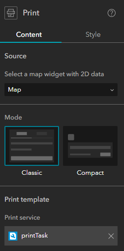

I want a very basic print option for my EB app, but the AGOL print widget will not work. I can select the OOB print service, but my print widget just opens to a printer icon, and the service selection doesn't stick:

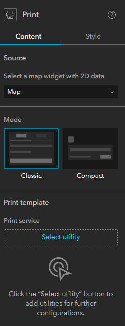

As soon as I close the widget configuration, even if I save while it's open, the service seems to disappear. The next time I open the widget it wants me to select the service again:
The same thing happens if I add a service and copy a URL from a working appbuilder app. It remains an option when I go to "select utility" again, but it doesn't give me a print interface or stick when I close out of widget cofig.
