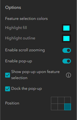

All three pages use the same Web Map for their Map widget, and the widget settings are identical:
However, I'm seeing strange behavior in the Map widget on Page 1 (the same behavior is not happening in the Map widgets on pages 2 or 3):
