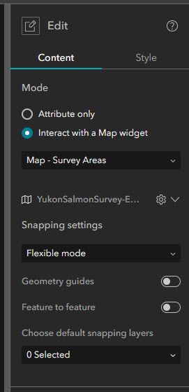

The idea is for easier viewing in case people don't know how to go in and turn on/off map layers. I noticed today that the one edit widget looks pretty good and for mode is selected to 'Interact with a Map widget' and I have one of the maps selected and below shows the map layers within the web map to enable for editing.

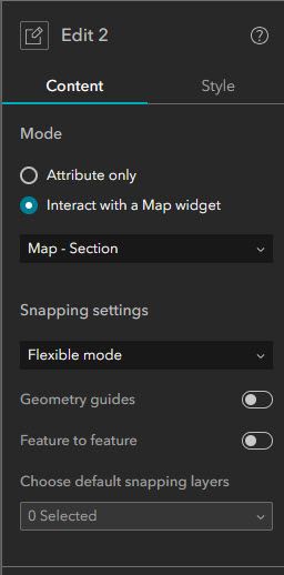

However when I go to the second edit widget which is another section view, this one also has the mode 'Interact with a Map widget' selected along with the second web map, but no layers show to configure. I have been able to switch to the other web map and then switch back to the second web map and then the layers in the second web map will show as options to configure editing.  I save and publish and get the green light, but when I go back to the second edit widget, no layers are shown as configured for editing or even show within the web map setting. What is going on?
Shouldn't this be possible to achieve with two separate web maps and two edit widgets? It is the same hosted feature layers being configured for editing so maybe that is too much for the EB?

In the screenshots below the first one shows the edit widget and interaction with the first map. The second edit widget despite selecting to interact with the map it doesn't provide an option to select map layers. I have been able to switch to the other map, layers immediately show and then switch back to the second map and layers to edit will be an option. I have saved settings and then go back to view the edit widget configuration and it looks like the second screenshot below in the layers have disappeared.
