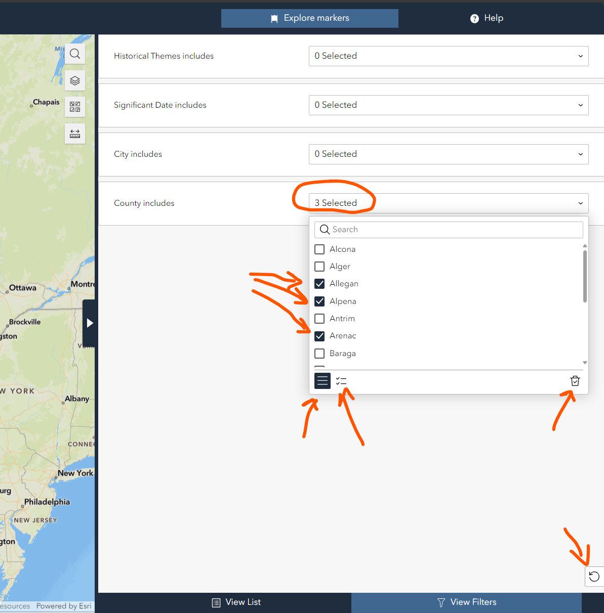

I want to create the type of filtering functionality that I saw in this experience (Michigan Historical Markers).
I have used the filter and query widget in ArcGIS Enterprise 11.3 but those widgets don't offer the configuration and functionality that I see in the filters of the link:
  • Selection count
  • Drop down with multiple selection options
  • Auto application of the filter
  • Show all and show selection button at the bottom of the dropdown
  • A refresh filter button at the bottom right of the section
Any ideas of how this was created?

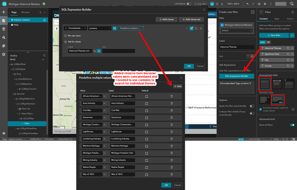

Hi @Billy I noticed this post after posting in another thread.  This was built from the stock AGOL filter widget and to make use of the check box/multi select, I have them set up like the screen shots below.  I used "contains predefined multiple values" in one filter and "is any of" in another to give options to the user. I would think these options are available in 11.3, but I havent tested that yet.

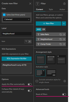

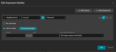

The multiple select can be achieved with the "is any of" option:
Auto apply and clear the filter are both options in the filter widget:
Show all and show selection should be standard of the "is any of" I believe?
Happy mapping,
- Zach
