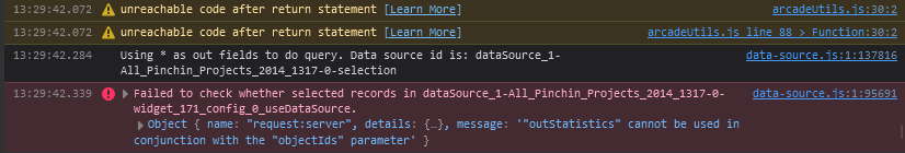

When a point is selected, the popup appears and immediately disappears.
This only started happening recently. I didn't change anything, so this effectively popped up out of nowhere. I get this error:
Anyone else familiar with this error/behaviour?
Currently trying to reinstall EB/Node.js and widgets. Maybe it's because I'm sick, but things just don't want to work right now...

Hi @abureaux,
I couldn't reproduce this issue at my side. Could you share an sample app for us to troubleshoot?

I may have isolated this issue, but I'm still getting the odd person reporting this behaviour. I'll give it a few days, and if it looks like it's resolved (I'm hoping clearing browser cache works for them), then I'll try and recreate this in dev and likely submit a bug.
