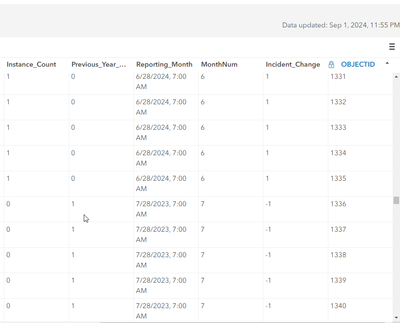

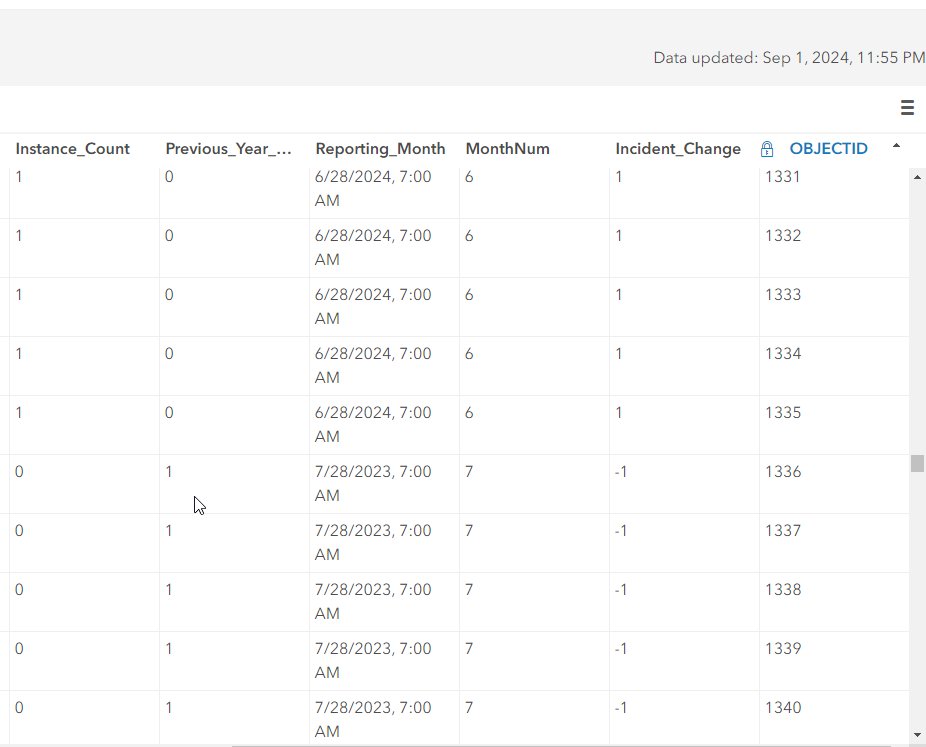

Is it possible to populate a text box with a dynamic expression as a percentage?
I have [Instance_Count] and [Previous_Year_Count].  I can use Arcare to calculate the Change [Incident_Change] as "$feature.Instance_Count - $feature.Previous_Year_Count"  However, I would like to show this change divided (/) by the [Previous_Year_Count].  It seems you are not able to write these long expressions.  Can you please advise how this can be accomplished.
Marshal
It would look something like below.  This would be configured to operate on the selection view of a specific layer, so that when a feature is selected it makes the calculation for that feature.  If multiple features are selected it is calculating based on the sum of all features.
((SUM({Instance_Count}) - SUM({Previous_Year_Count})) / SUM({Previous_Year_Count})) * 100 + "%"
