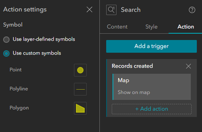

Have you configured the locator source in the search widget? If configured, the Records created - Show on map action allows you to set custom symbols for locator results.

Hi @MaryEllenRosebrough-Gay ,
In Experience Builder, the search widget does not set this search behavior automatically. You can add the following message actions to the search widget: Records created - Map - Show on map.

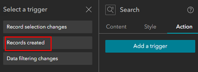

I'm not seeing Message Actions as an option on the search widget that you drag over from the + Insert Widget, but I enabled the search on the web map itself and that does add a symbol for the location. I can work with this, but if there is a way to do this in the search widget that I configured with all the layer searches, that would be wonderful. I can't find the spot. I'm attaching screenshots of where I'm looking and my current work around of using the second map-based search option.
ShengdiZhang
Yes, I have both layer sources and the Esri locator. I see it now, thank you!
