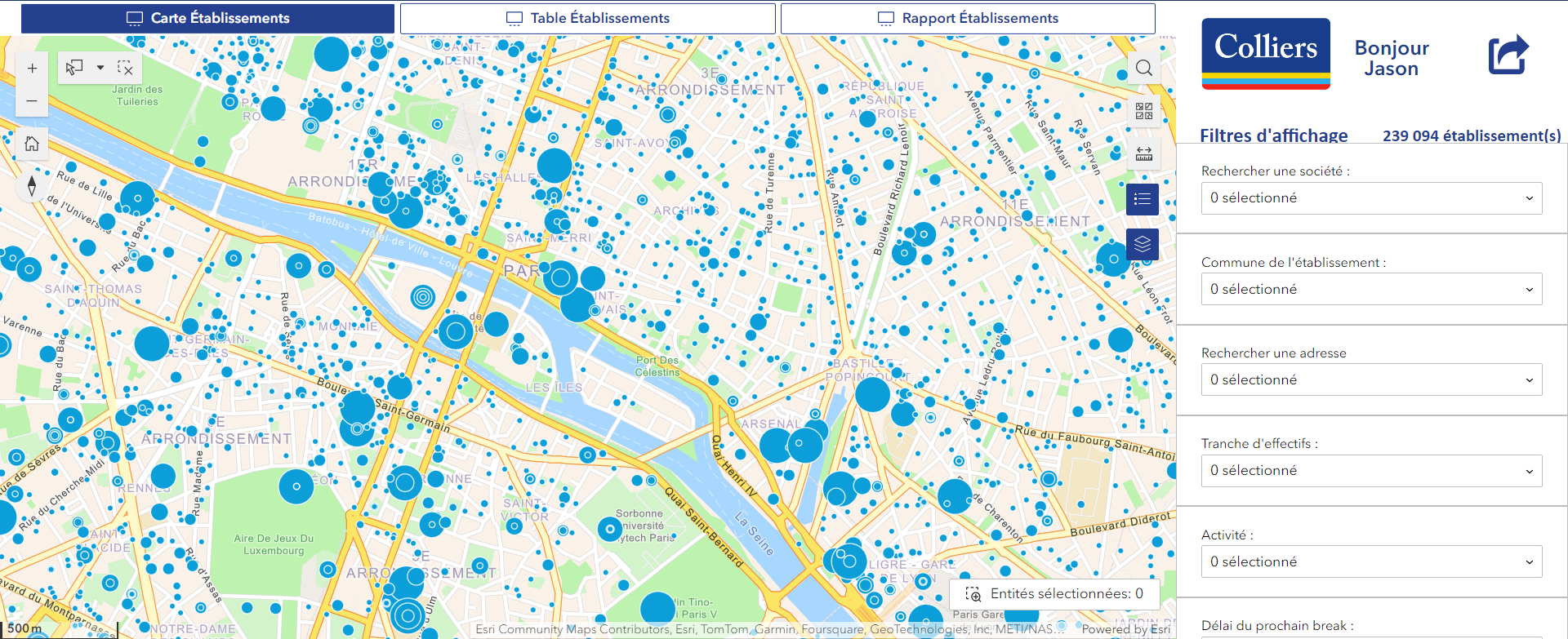

as you can see, the first tab is a map view, the second tab is about a Table view.
The right side is about to filter the data on the map and on the Table.

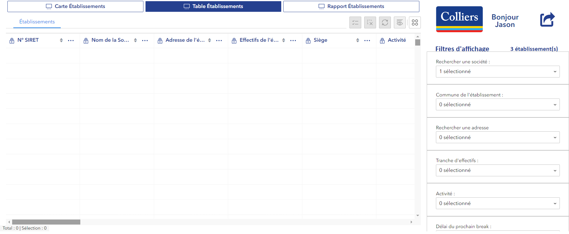

So here is the problem : When you enter on the application you are on the map tab view. If I don't click on the "Table Etablissement" tab, then I use filter and finally click on the Table tab, the widget is blank.
As you can see on my screenshot, on the right the counter was correctly actualized with what I filter (3 establishment remaining) but the table is not actualized.

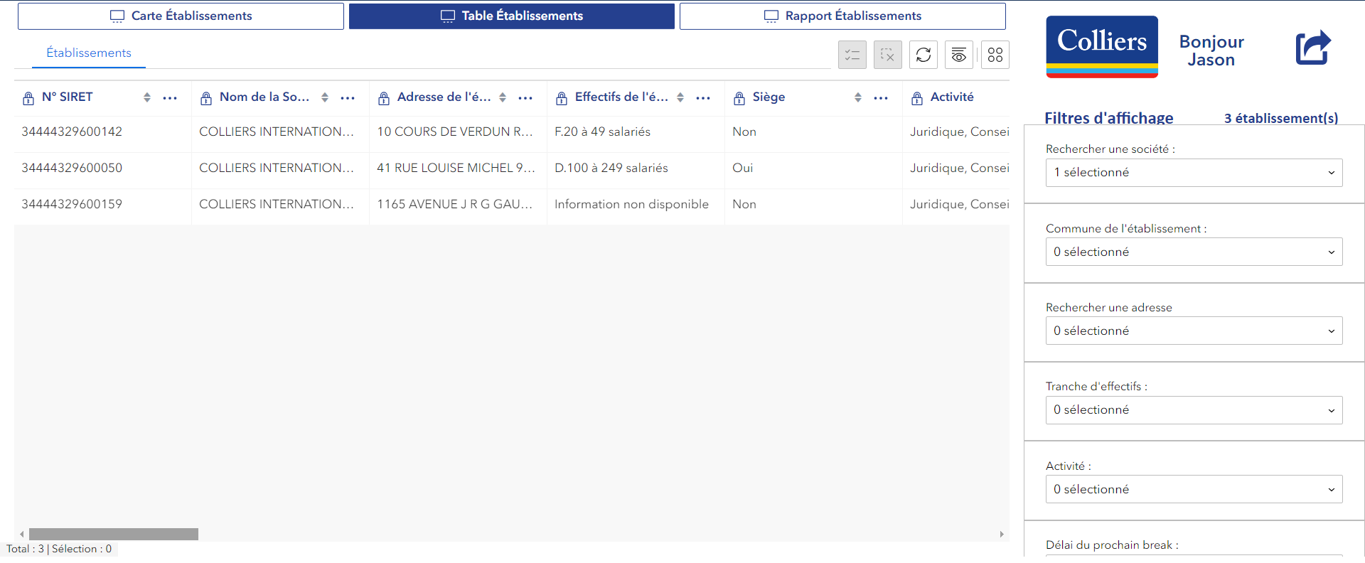

Now, if I launch my application, click on the Table tab, back again on the Map tab and do the same manipulation (filtering data and click on the Table tab) the data appears correctly on the Table.
As you can see on this screen, now it's working.

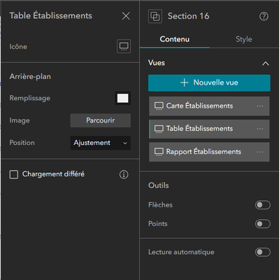

I look for the Section Widget parameter and I see this :
The Lazy Loading was not crossed.
So I made a test : launch my app without checking the box : obviously the bug is present.
I launch again with checking the box (only for the Table tab) : I filter on the map tab and click on the table tab and WOW magic, IT WORKS ! my tab loading and was actualized, not blank !
But it keep a mystery : I'm going again on my 1.14 dev edition to see if I have check this box before... and the answer is nope. The table loading correctly without checking this functionnality on 1.14
tl;dr : on 1.14 everything works, box checked or not. On 1.15 i'm forced to check this box to have a result on my Table tab view if I filter before clicking on this tab.

@JasonBOCQUET thank you so much for providing so many details to troubleshoot. Based on your description I can confirm this is indeed a known bug introduced from the ArcGIS Maps SDK featureTable component. The bug is: Sometimes the table widget shows blank records when filters are applied. These blank records should be filtered out. Both the Experience Builder team and the Maps SDK team are aware of this issue.
From the ExB side, we made a fix in 1.15 that the table widget forces to refresh itself whenever the filter on the data changes. Unfortunately, it wasn't able to cover the case we're facing at the moment - the table widget is invisible when the filter changes, so when the table renders (the filter does not change at that exact moment but before) it doesn't refresh itself. The best way to verify what I said above is to refresh the table when you see the blank rows. It should display the correct results after the manual refresh.
That's why you see different behaviours when the lazy loading option is on/off. If you turn on lazy loading for the table tab, the table widget will only render until you go to the tab so it can pick up the filter changes.
We are working to get this solved in the next release. For now please check lazy loading as a walkaround. Thanks again for your time on this issue!

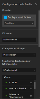

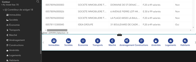

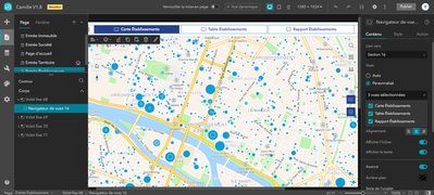

Hi Jason, thank you for the feedback. Looks like you are using a Views Navigation widget to switch between views. I did something similar but was not able to reproduce the bug you encountered. Can you share more information on the design of your app? A few screenshots on TOC, types of data sources and app layout would be of great help. Thanks!
Shen Zhang
JasonBOCQUET
Hi @Shen_Zhang thanks for your reply !
Yes I used a View Navigation Widget to switch between my views.
Here some screen that I hope can help to solve the problem :

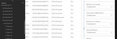

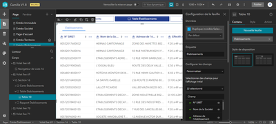

Here you can see the View Navigation Widget embed on a Fixed Panel Widget with the 3 views in the right panel.
Here the second Fixed Panel widget who contering the Section widget which manage the 3 views. I develop the "Table" tab view to see the widget and on the right the settings.
The other 2 Fixed Panel are here to manage the bottom page with the button to see layers by thematics
and to manage the Filter Zone on the right side of the application

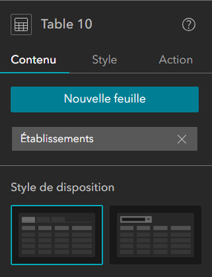

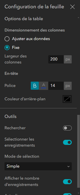

For the Table Widget specifically :
JasonBOCQUET_5-1725523878257.pngJasonBOCQUET_5-1725523878257.pngJasonBOCQUET_6-1725523886540.pngJasonBOCQUET_6-1725523886540.pngJasonBOCQUET_7-1725523905013.pngJasonBOCQUET_7-1725523905013.png
For me there is nothing specific on the parameter;
I change litteraly nothing between the 1.14 and the 1.15.
But in 1.14 it works without any problem. In 1.15 I have the problem that I describe.
To finish, the data on my table are the following : 240.000 rows with 32 collumns, Data, Int, Text  data type, nothing strange.
I don't know what other kind of information can I give to you ; tell me if you need something else ?
So, what's going on to this difference between 2 versions ?
Shen_Zhang
