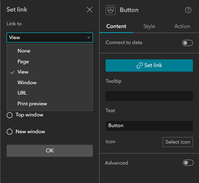

Instead of using the Views Navigation Widget, make links to your view. You can do this with the Button Widget or the Text Widget, either way there is an option to make a link to a view. You will need to do this for every view which will be a bit annoying, but you will have much more control over how to display these links.
