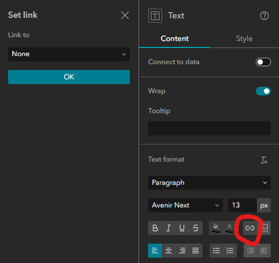

JeffreyThompson2
MVP Frequent Contributor
  1. Add a Widget Controller.
  2. Place a Text Widget inside it.
  3. Use the Set Link option on the text.

GaryBarden
Thanks....
