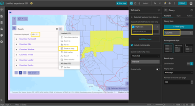

Hi @ClaraRiechmann,
You can use the Select or Query widget.
Steps:
  1. Add the polygon layer to the Query widget.
  2. Go to Spatial filter, Selected features from data source, and set the spatial layer as the line layer.
  3. Turn on Live view.
  4. Select a line and run the analysis.
