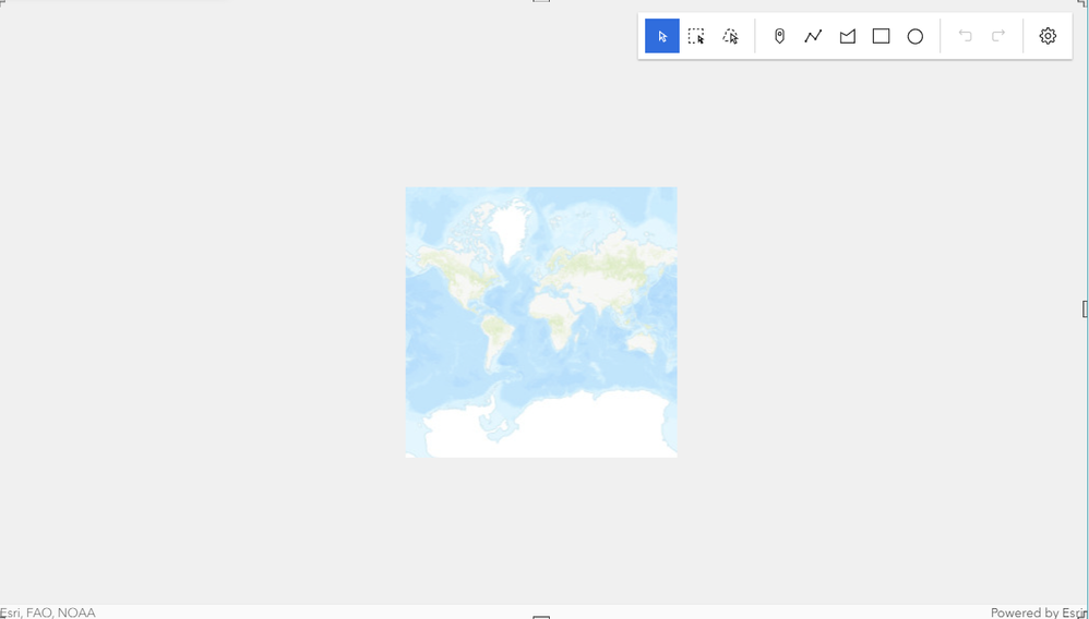

You can also add a similar DrawBox function to the map through a custom widget, looks like this (top-right):
