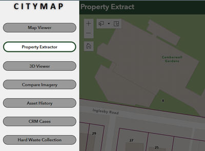

Is the button & hyperlink meant to open a new window of the dashboard? It defeats the purpose of using embedded views & pages or am I missing something.
In my ExB site how would I get the Property Extractor app to open in the main panel on the right?
