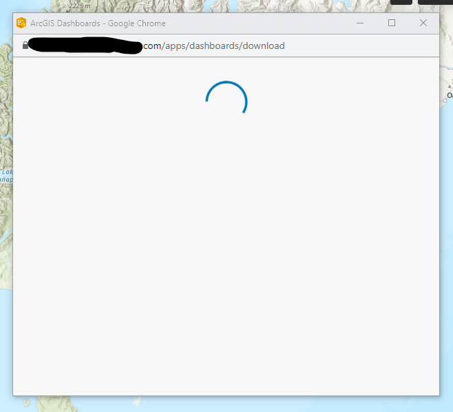

Kia Ora Team,
I created a couple of products using Experience Builder a couple of months ago. I embedded dashboards that enabled users to download data from a list. These as of three weeks ago seemed to work as expected. Fast forward to this week, this does not work.
I tested the download data function in the dashboards (outside of EB) and these work. It just when I try doing this from the embedded dashboards within EB.
This is what I get (it is the never ending loading page) - in both Chrome and Edge.
Any ideas?

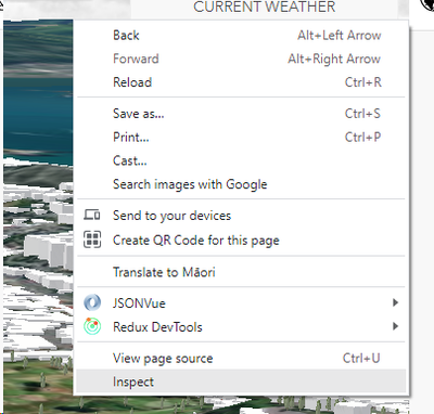

It's difficult to tell based on the screenshot, but its likely that there is an error logged in the browser console.
Can you do the following,
1. Right click on the window that has loaded (or not) the one with the loading symbol.
2. Click on the Inspect button
3. Select the Console tab, and look for any errors.
4. If you can screen shot them and reply to this, then I might be able to help.

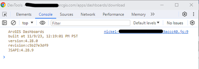

SummerKoszti
Hi Grant,
This is what comes back:
and it looks like the other one has nothing coming up now (waiting 10 mins).

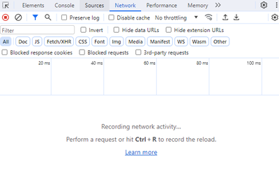

Grant-S-Carroll
Ok, not much there, can you check the network tab, and scroll to the bottom of the page?
SummerKoszti
... nothing...
