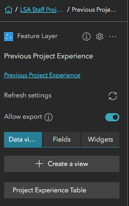

I'm trying to enable export for a table in an Experience Builder app on Enterprise 11.2. Export is enabled for the data source:

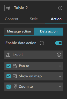

But the option to enable export in the table widget's actions is unavailable:
What am I missing? It's probably something simple... this is the first time I've attempted to add a table to an Experience Builder app so I could definitely be missing something obvious. Thanks in advance for any help you can provide!

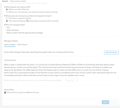

In AGOL/Portal for the Item details under the Settings Tab have you checked on the Export Data option?
HollyTorpey_LSA
Yes, export is enabled. Thanks, @ChrisRoberts2!

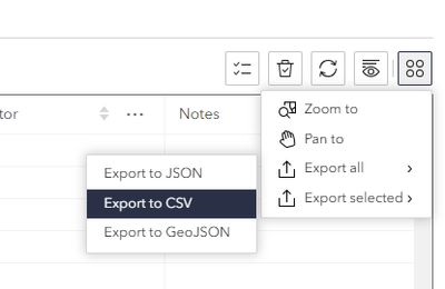

It turns out the "problem" wasn't a problem at all. It was enabled all along (even though it still doesn't have a checkbox in the Data action panel like the other actions, which is what made me think it wasn't enabled). I just didn't know where to find it in my own interface. 😝
I was expecting the same download icon to appear that is used in Dashboards and elsewhere, but instead the export option was included in this icon along with other data actions:
