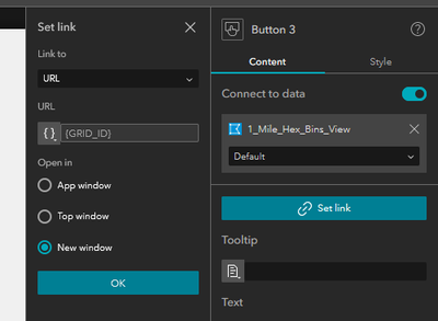

Table cells do not automatically detect URLs and make them linkable as they do elsewhere, like on a Content item's page. The only way to use an attribute as a hyperlink is to use a widget that allows linking in the first place, like a text or button widget.
