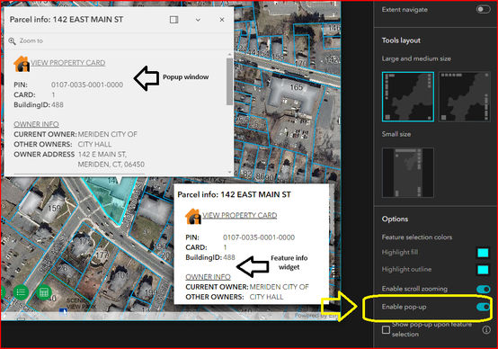

It seems like I am missing something here. I want the feature info widget to populate when I click on a parcel but I don't also want the popup window to open.  How do I do that?
I’m using Enterprise/ExB 11.3.  I’ve added a feature info widget.  The only way I can get the Feature Info widget to populate like an ID window is to enable “Enable pop-up” on the map widget.  Otherwise, it’ll only work using the select tool, which requires user to take some extra clicking steps.
Below, feature info widget only populates with "Enable pop-up" on map.  As you can see, this is redundant:

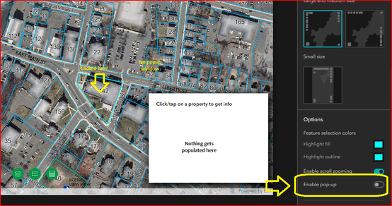

But if I disable "Enable pop-up" on the map widget, feature info widget does not populate.
What am I doing wrong?  Thanks.
PLadd
Kudos to ESRI tech support for walking me through to a solution. Using ArcGIS Pro 3.2.1, I needed to republish my web map. It had originally been published at ArcGIS Enterprise 10.9.1 and I am now at 11.3 so republishing got everything up to 11.3 (Experience Builder and now web map). This allowed the feature info widget to populate as a popup window on map click with the actual popup window disabled on the map widget.
