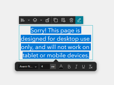

Now insert a new Text widget that has the message you want. This is a great place to use the VW font size setting, as your font will adapt to the screen size that way. Set the size of the text box to auto, and center it in the page.

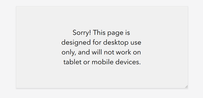

Here's my Experience, being previewed on a landscape mobile view.

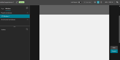

Splash screens and other windows can also have a custom layout setting. Just repeat those same steps, but with the window selected in the table of contents. You can't change the window's settings without affecting the full-screen view, but you can change the contents of the splash screen to display a duplicate "sorry" message as the page underneath.
