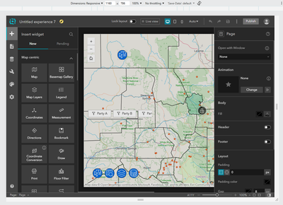

JeffreyThompson2
MVP Frequent Contributor
I think your home set up is the problem, but it's not a VPN issue. Playing around with the screen size simulator in Chrome, the Preview Button disappears at a width under 1160px. Try using your browser tools to zoom out a bit and it should come back.

ToddTurner2
Well - you're onto something, there.  If I zoom the Chrome browser to 250%, the Preview option shows up in the three dot menu.  Anything less than that and it disappears altogether.
I have, of course, completely cleared the Chrome browser cache, all types, for all time. (several times). I have now played with the screen size simulations, and experimented with the screen size settings for the EB project.
I will say that it is working just fine in Edge at the moment. However, I have never accepted switching browsers as a real solution. I will continue to investigate.
