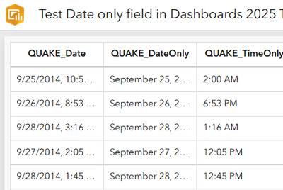

SavannahThomson1
Hi Emily,
Date Only fields do not show up in tables added to experience builder or dashboards. You can see the first screen shot is from the data tab on the item description and the second screen shot is the table added to experience builder with the date field missing. My workaround was converting those fields to text in excel before publishing so they'll appear in my apps.   
EmilyGeo
Are you using ArcGIS Online? Experience builder recently added support for the new field types with the June 2025 update. See the What's new blog article here https://doc.arcgis.com/en/experience-builder/latest/get-started/whats-new.htm
SavannahThomson1
This is in Portal but that is exciting to see it has been added!
