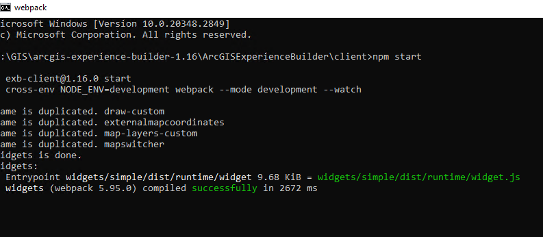

Recently I removed EB DE 1.15 from my development server and deployed 1.16. When I run npm ci, npm fund, then npm start, I get the below results of saying the widget name is duplicated. I went to update the widget.tsx in one of the widgets, but the updates are not pushing through into the widget itself. I am missing some steps about migrating widgets from one version of EB DEV to another. I did copy and paste the widgets from the 1.15 to 1.16 file path...\ArcGISExperienceBuilder\client\your-extensions\widgets folder. Instead of editing the code in file path...\ArcGISExperienceBuilder\client\your-extensions\widgets, should I be editing the code in file path...\ArcGISExperienceBuilder\client\dist\widgets?

One thing I would check after changing versions, is ensure you are starting everything fresh. (May or may not need a cache clear)
It's my understanding that what ends up in DIST is not always the same as what is in your-extensions/widgets/foldername (Often its reduced to a single .js file)
if you have a message about a duplicate widget, double check the manifest.json file most often its the name key that needs adjusted.

Thank you @TimWestern. If I change the name of the widget folder in ...ArcGISExperienceBuilder\client\your-extensions\widgets\mapswitcher and the name in the manifest.json for each widget, it works. However, existing applications created in DE break the widgets and require them all to be reconfigured because of the name change. I did clear the cache on the client and server folder by running npm cache clean --force, which did not seem to change anything for this issue.

oh yeah, folder name not matching is so easy to miss.  I forgot to mention that one.   It's bit me on several occasions.

I think it was my order of operations. During my first attempt, I updated version 1.16 and then imported the application ZIPS from 1.15 to 1.16. The second time, I did a fresh install of 1.16 and then copied the widgets into the ArcGISExperienceBuilder\client\your-extensions\widgets\ folder. After that, I imported the application ZIPS from an export from 1.15.
