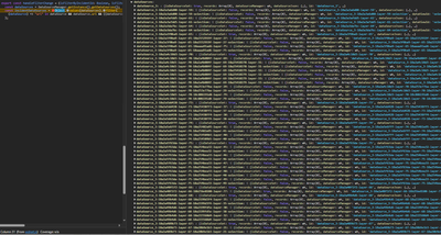

I'm wondering if something has changed with DataSourceManager.getInstance() between v1.11 and v1.13 and I need to modify my code or this is a bug.

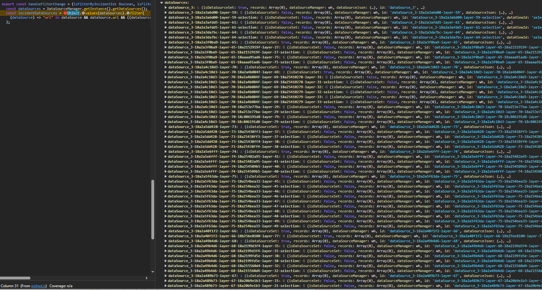

At v1.11, when I call DataSourceManager.getInstance().getDataSources() I get all the dataSources in my map:

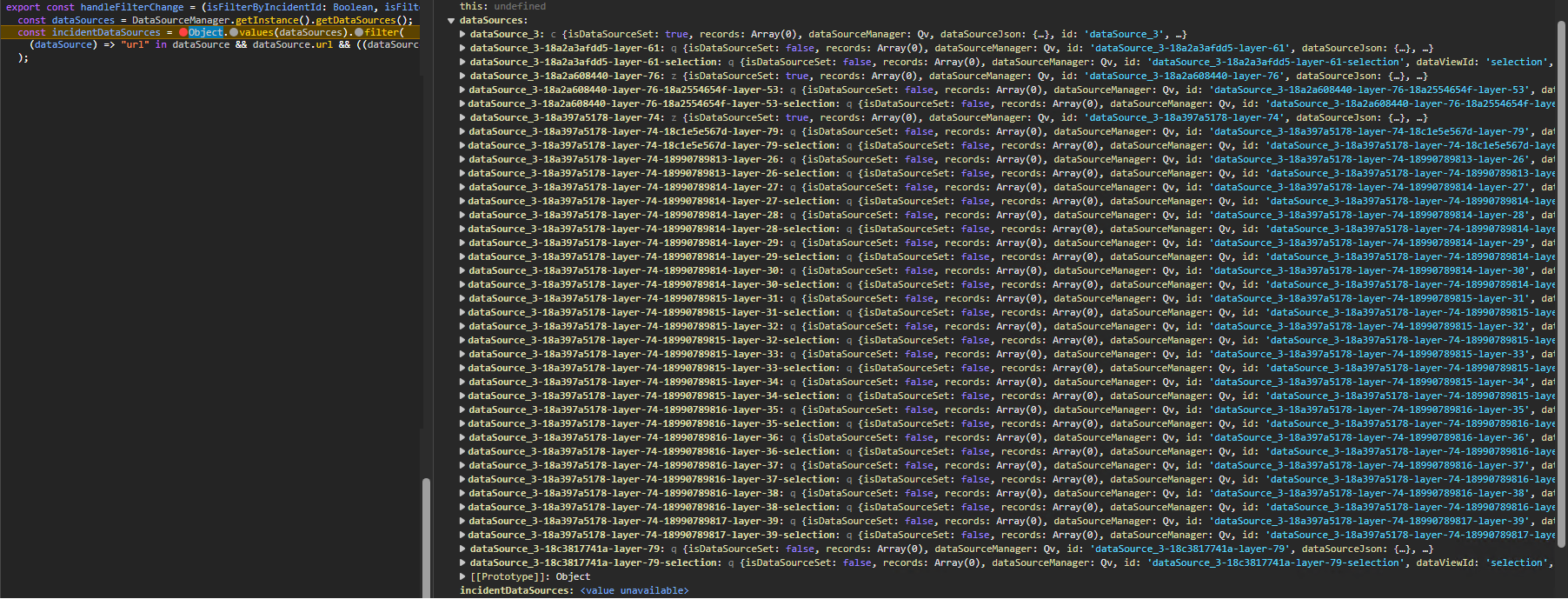

After upgrading Developer Edition to 1.13, the same DataSourceManager.getInstance().getDataSources() only gets a subset of the dataSources:

Hi @LeonAus, this is most probably related to breaking changes in 1.12 - not all data sources are created by default anymore. See the documentation for more details: https://developers.arcgis.com/experience-builder/guide/1.12/whats-new/#datasource
